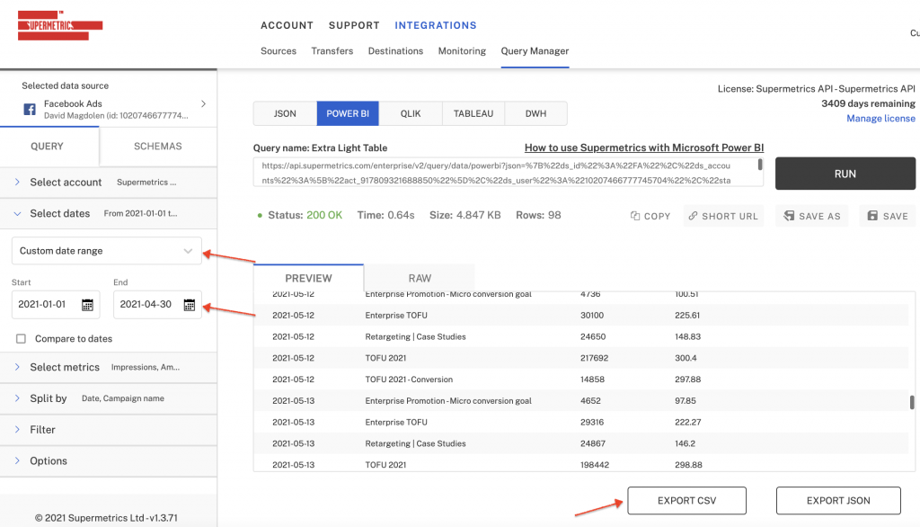

Step 1: Download your historical data from query manager

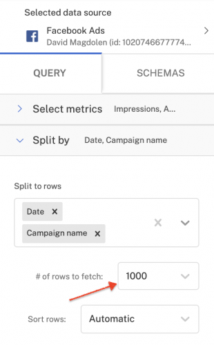

Supermetrics’ query manager is a great place for profiling your data before loading it into your BI tool, but it can also be used to export historical data from your marketing data sources. Simply run your query for the dates you’re interested in, and use the button at the bottom to export the results to a CSV.
Pro tip: since the query manager is designed for data preview, it automatically limits the results shown to the first 1,000 rows. You can change this using the option under the “Rows to fetch” option under the “Split by” dropdown.
You may need separate CSVs if your data is too large, perhaps one per year, per quarter or per month depending on your data size. See the “Limitations” section below for more details.
Step 2: Configure your incremental URL
Historical data is great, but it’s static and unchanging. You want to be able to click one button and have Power BI pull in the latest data directly from your sources. This quick trick can help you do just that.
In ‘Query Manager’, go to the ‘select dates’ section. Select your desired start date, then write ‘today’ as the end date—overwriting the date in YYYY-MM-DD format—then run the query once. The start date parameter should stay fixed, but make sure that it aligns with the last day of data in your historical export.
You can now import the URL shown into Power BI, and Supermetrics will see ‘today’ as the end date of your query and return all of the available data up to the given day when Power BI goes to refresh the query.

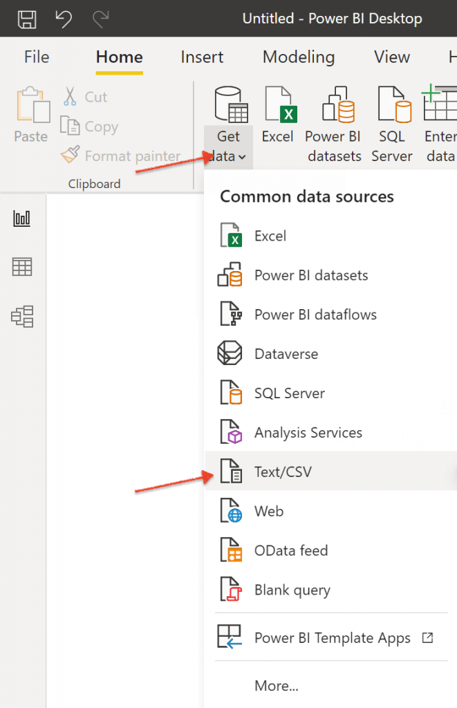

Step 3: Import your historical data into Power BI
Next, you’ll load your historical data into Power BI. Note that if you have large datasets, it might be advisable to break your data into multiple different files rather than one single large file.

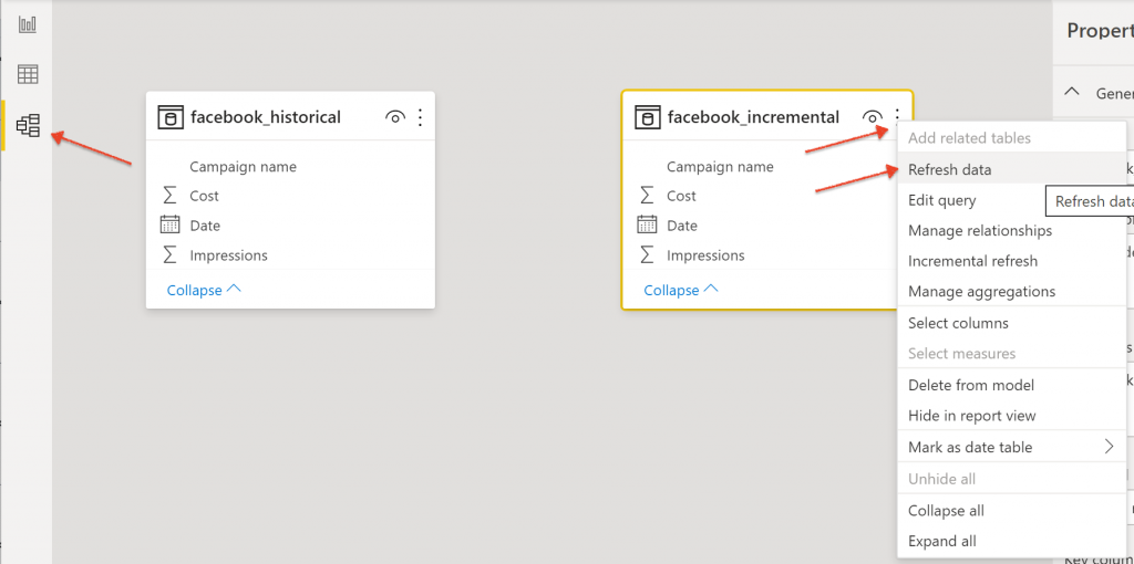

I’m going to do this and rename my table “facebook_historical”.

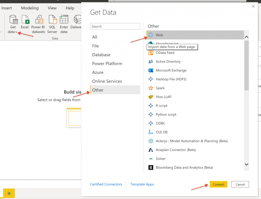

Step 4: Import your incremental data query
After you’ve imported all of your historical data, you’ll use your modified query URL from the query manager to set up a web-based data source. For additional instructions on this, follow these steps .
I’m going to name this table “facebook_incremental”.

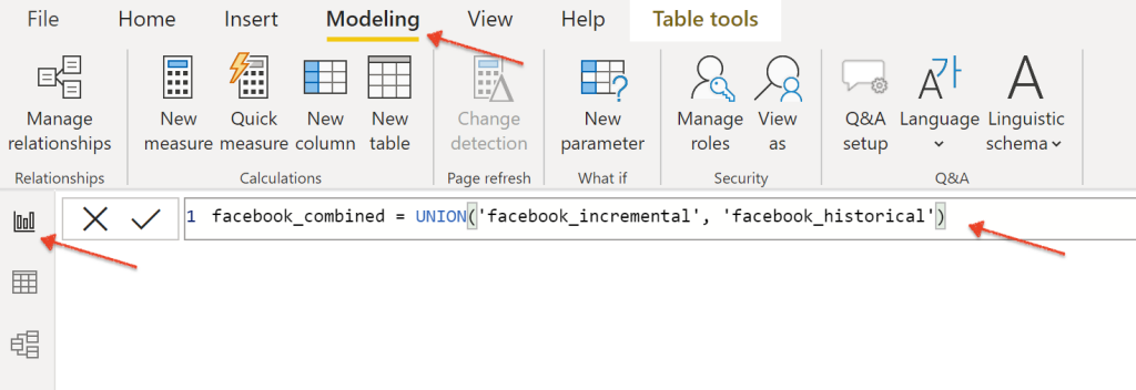

Step 5: Create a calculated union table
In this last step is where the magic happens.
Now, we’re going to create a calculated table that merges our two tables as one. The (UNION) function in Power BI can take any number of tables and perform a SQL-style UNION on them. Basically, that means that with this single calculated table, you’re able to build visualizations based on the data contained in both “facebook_historical” and “facebook_incremental”.
The best part about this is that when you refresh your incremental table, your refreshes will run significantly faster since you’re only pulling a few months worth of data from the Supermetrics API rather than potentially several years.
