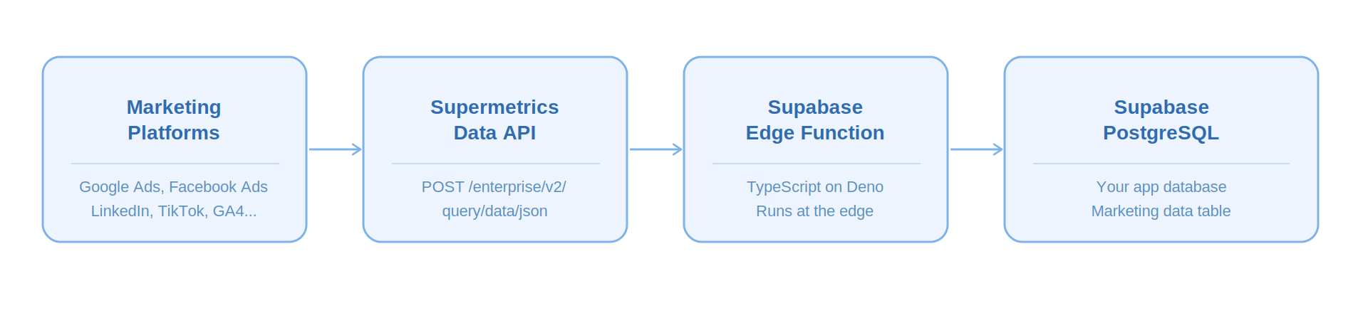

Put Edge Functions and the Data API together, and the architecture looks like this:
The Edge Function authenticates with the Data API, pulls the marketing data you’ve specified, parses the response, and inserts rows into a Postgres table. Your API key stays server-side, the function runs at the edge, and your marketing data lands in the same database as the rest of your app.
