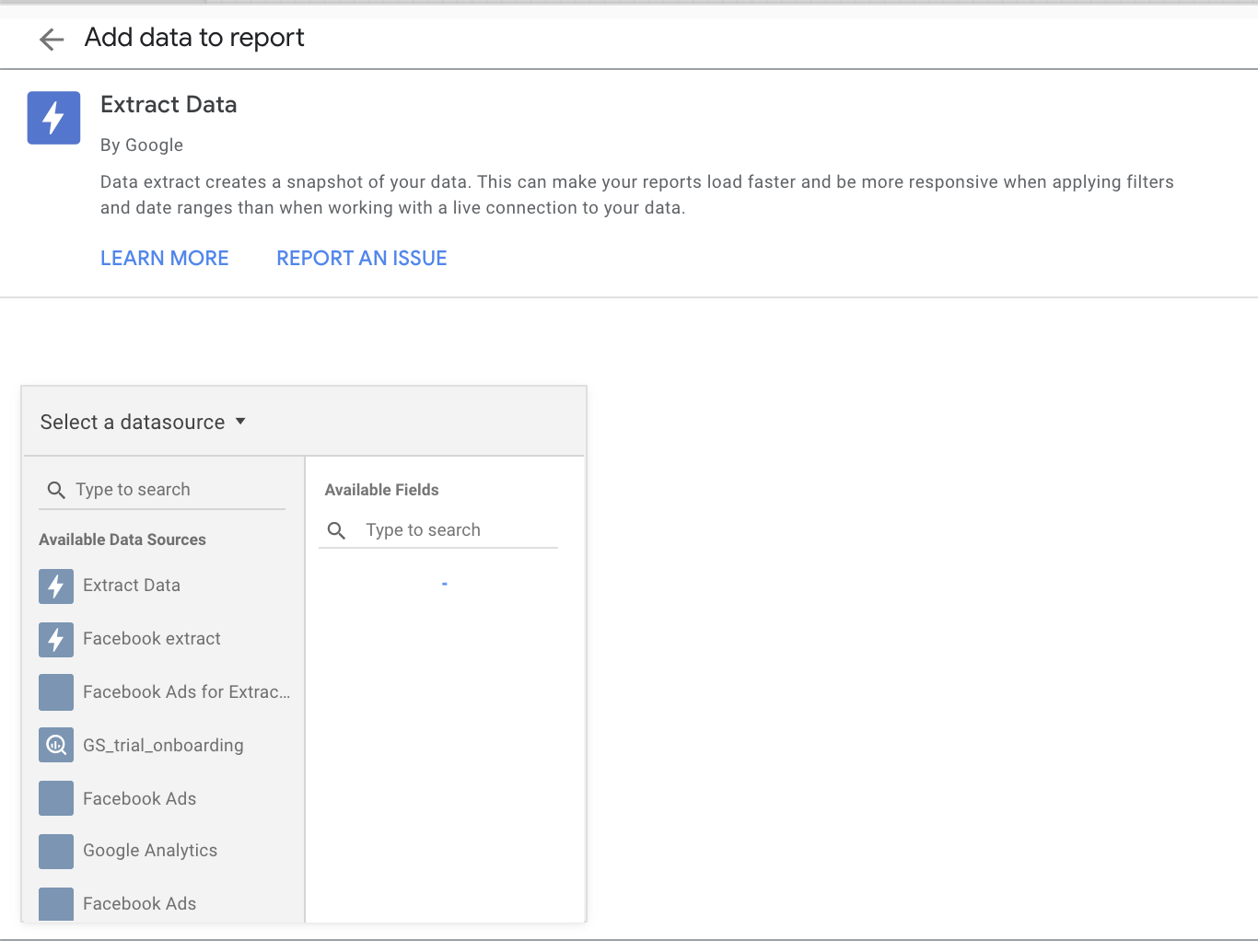

  1. You can link a data source with Google’s Extract Data connector and pick the fields you want to use in your reports.
  2. The connector then extracts and stores the selected data, which is updated at set intervals.
  3. Then, Looker Studio uses the stored data rather than fetching live data from the data source, so your reports load much faster.
  4. You’ll have full control over what data is stored, and you can delete the stored data by deleting the Extract Data source at any point.

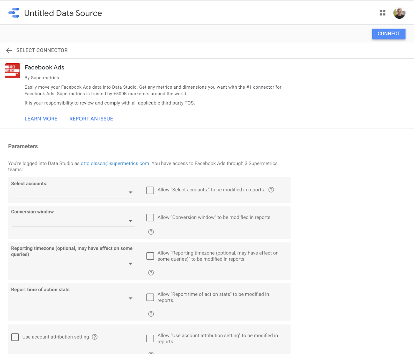

Select the data source you’d like to extract data from.
Set the connection parameters and click ‘Connect’.
The Extract Data connector works with all connectors.
After you‘ve set up your connection, you can link it with the Extract Data connector.

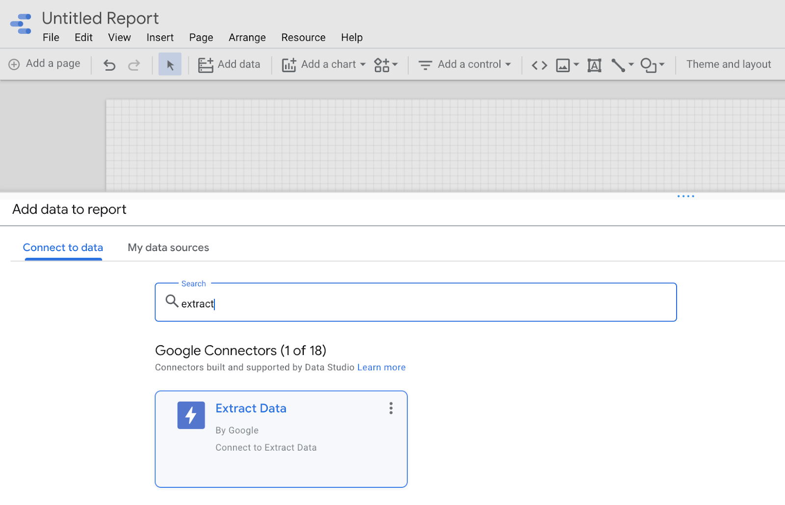

The Extract Data connector is available in the connector gallery under ‘Google Connectors’.
Add the Extract Data connector to your report.

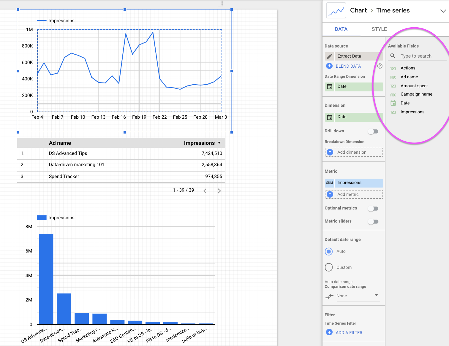

Select the metrics and dimensions you want to have available in your report.
Select the date range and add possible filters to the data.

Now, you can use the Extract Data connector like any other connector. The available fields and date range are based on what you selected when setting up the connector. The data is updated automatically from the data source based on the update frequency you selected.

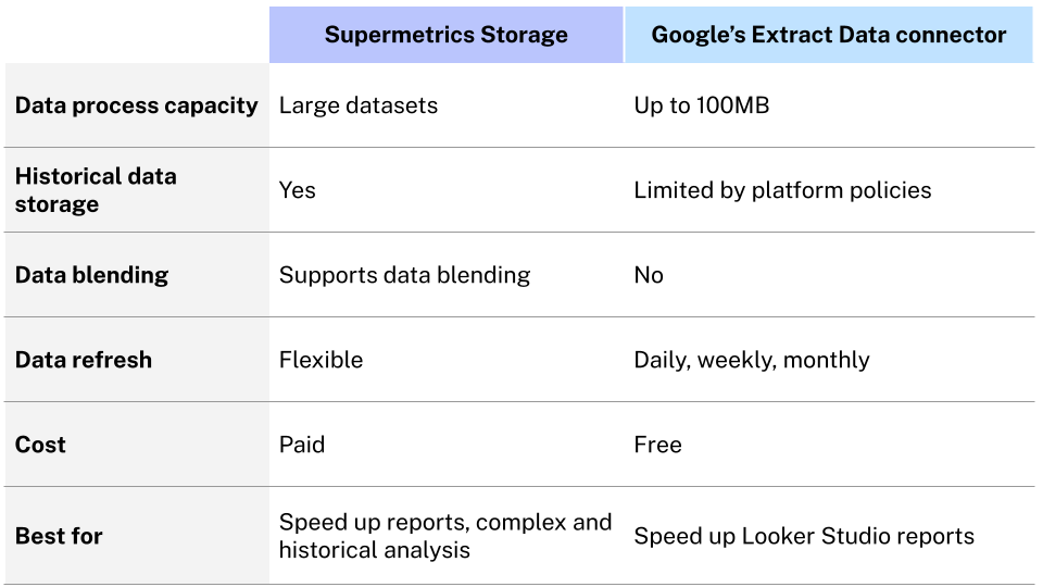

Which one is right for you?
Both Supermetrics Storage and Google’s Extract Data connector solve the issue of slow loading times in Looker Studio. But, they cater to different reporting needs.
Supermetrics Storage offers a more robust solution and is a great way to get the benefits of a marketing data warehouse but without the required technical resources. Since it can handle a larger amount of data (data that can’t fit in a spreadsheet), it lets you store historical data and go beyond platform limitations. For example, Google Analytics 4 has a 14-month data retention policy. After this period, your data will be gone for good. Supermetrics Storage is ideal for companies with complex reporting needs or those who want to perform in-depth historical analysis.
Google Extract Data connector is a free and simple way to improve report speed. It’s best suited for situations where you need faster loading times for reports with a limited set of frequently used metrics and dimensions. The data refresh schedule is limited to daily, weekly, or monthly intervals, and the storage capacity is capped at 100MB.
Our advice is that if you don’t work with that much data and want to speed up your Looker Studio reports, Google’s Extract Data connector is great. On the other hand, if you want to get the benefits of data centralization and improve marketing reporting efficiency in the long run, Supermetrics Storage is a better option.
