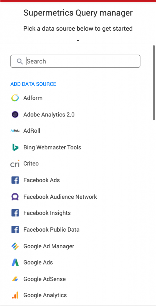

To get started with the schema builder, log in to the query manager.
The query manager is a universal user interface for managing all your Supermetrics data transfers, including those in Supermetrics for BigQuery. With the query manager, you can easily build your own schemas.
Step 1: Set up your schema
To start building a schema, the first thing you’ll want to do is select a data source.
After logging in to the query manager, you can simply select the connector you are building a schema for. If you haven’t used the selected connector before in the query manager, you might have to authenticate your connection first.
After selecting the data source you want, click on the “Schema” tab and select “New schema”. Next, type in the name of your new schema and confirm.

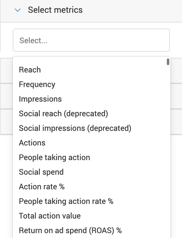

Step 2: Set up the metrics
You’re now ready to start selecting the metrics and dimensions you want in your new schema.
Make your way back to the “Query” tab and configure your query. You can freely select your metrics, dimensions, and timeframes. These can be selected from the query manager menu.
After setting up the query, test it by clicking on the “Run” button. If you’re happy with the result, click on the “Save as” button to add your query to a schema. Give a name to your query and select the schema you created.
Create as many queries for your schema as you need. Then pat yourself on the back, because you’ve just successfully configured your first custom schema!

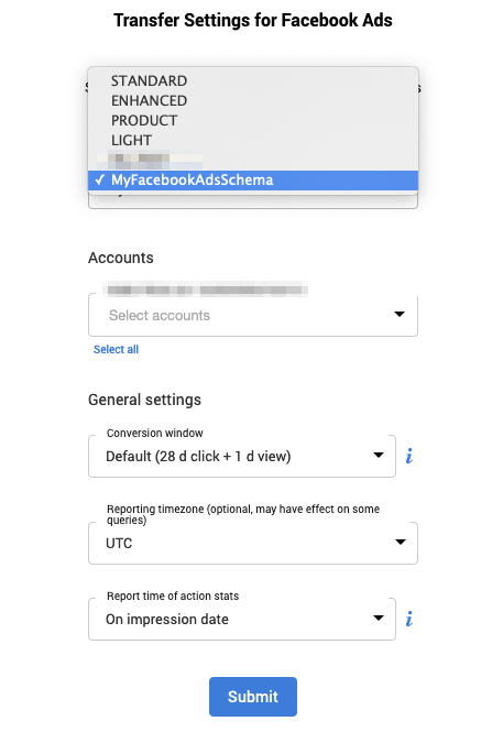

Step 3: Add your custom schema to your data transfer
Scroll over to your “Transfers” tab in the BigQuery console. You can either choose to create a new transfer (if you need a refresher, check out how to create a new transfer to BigQuery) or reconfigure an existing transfer to use your new custom schema.
When you have your transfer selected, click on the “Configure transfer” button. You will now see a dropdown menu with all schemas, including any custom schemas you’ve built. Pick the schema you just created, click “Ok” and save your changes. Your data is now transferred according to the new schema.
