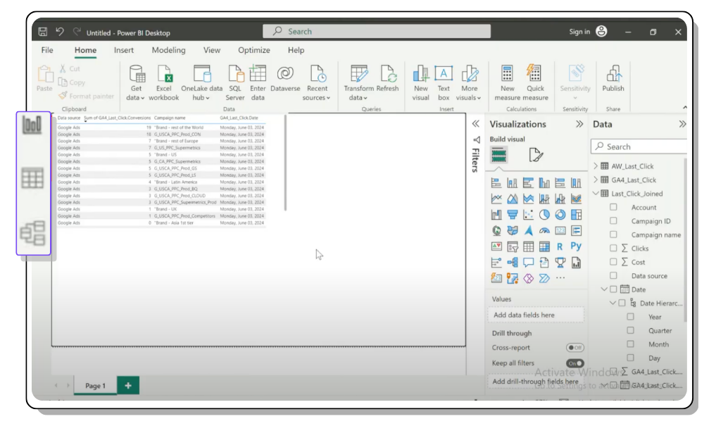

Report view
First, you have the report view. This is the final destination, where your transformed data comes to life as reports with tables, charts, and visuals. You can download this as a PDF or share it online with your stakeholders.

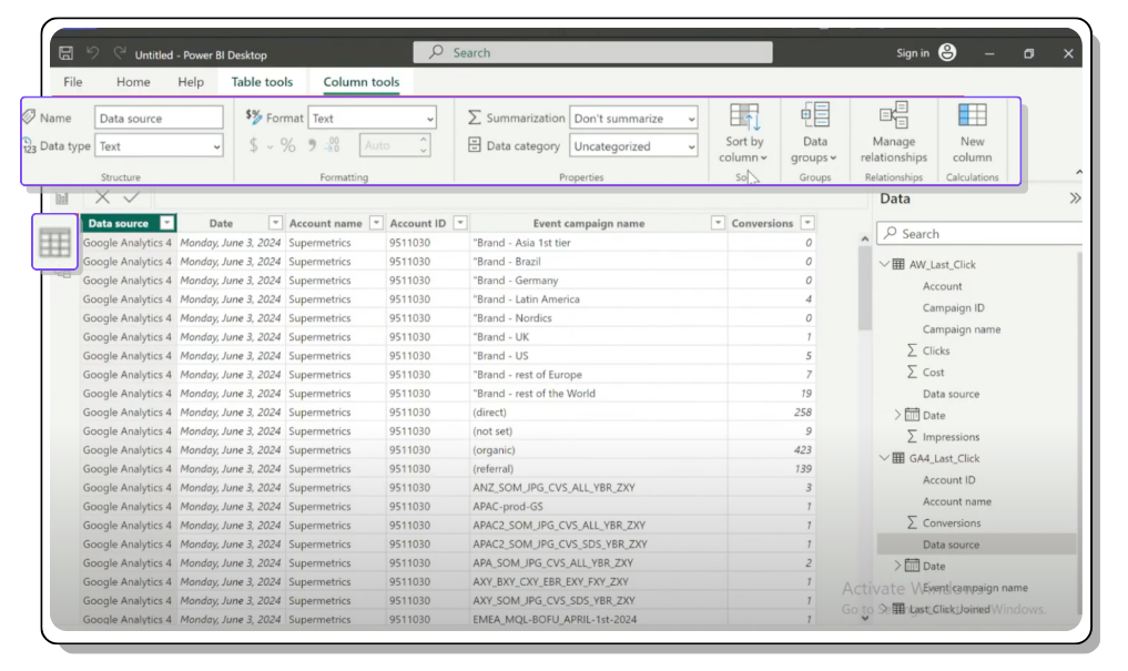

Data view
The second one is the data view. This is your playground. You can perform transformations like renaming fields, recategorizing data, and changing data types. You can get your data in the perfect shape for visualization.

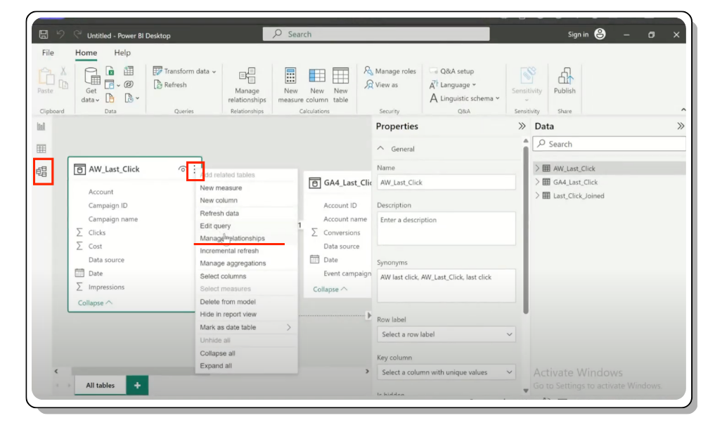

Model view
The third is the model view, where the magic of connecting the dots happens. Here, you can establish relationships between different data sources. Imagine you have data from Google Ads and Google Analytics 4. In the model view, you can link them based on a common field like “campaign name” to create a unified dataset for analysis.

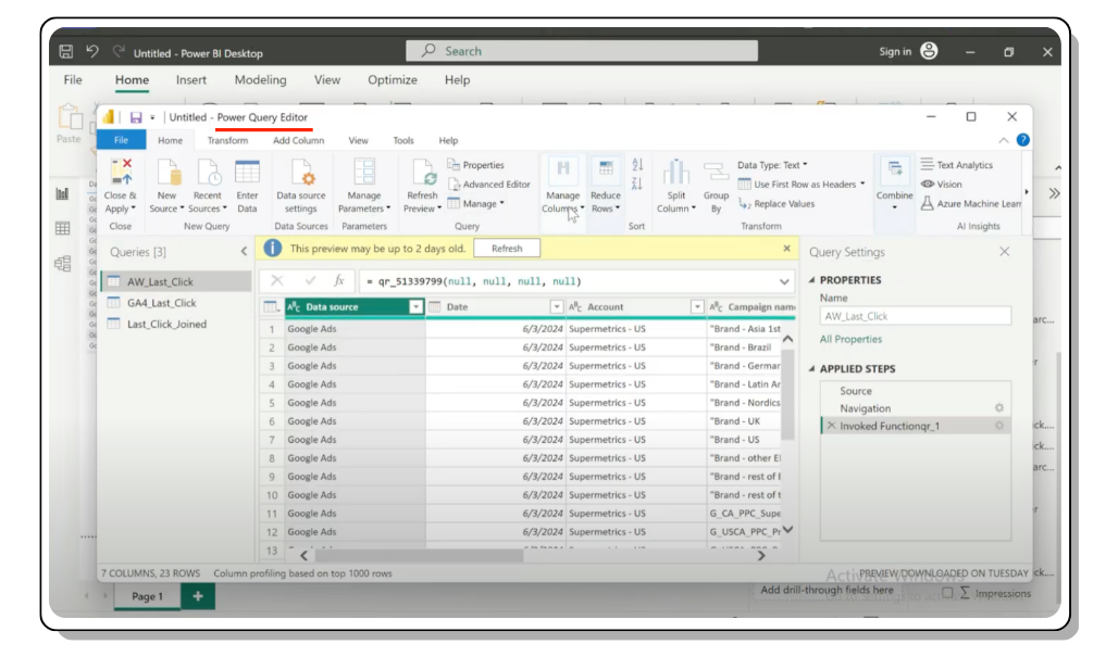

Power Query
The Power Query editor is one of the most powerful features in Power BI. It’s built-in transformation software that allows you to transform data into any shape you want. In addition to visualization, it offers various functions. Many free tools, like Looker Studio, don’t have anything similar.
You can access it from different places in Power BI using the “Transform Data” button, which opens a new window with the Power Query editor.
You can see all your tables in Power Query and perform various transformations—manage columns, change data types, combine data, etc. We’ll show Power Query in action in the use cases section.
