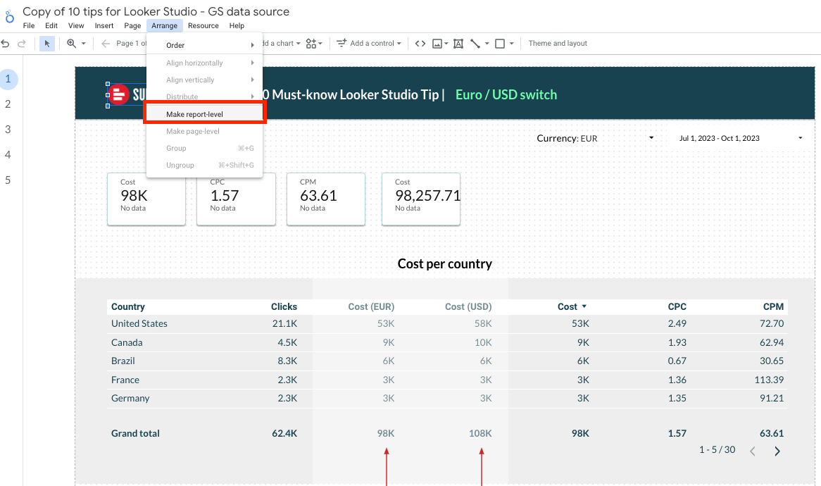

Let’s start easy. The first Looker Studio tip is to master the report-level components. As a marketer, you’re most likely advertising in multiple channels. In that case, divide your dashboards into multiple pages by the marketing channel or campaign.
To keep your dashboard consistent and aligned with your brand, you should use similar elements on different pages—headlines, colors, or your logo. The easiest way to manage these branding elements is to set them as report-level components. For example, if you edit the component on one page, it automatically copies the changes to each page.
If you can’t immediately see your elements on each page, don’t worry. Report-level elements are positioned at the bottom by default. You can fix it under “theme & layout”, select “layout, and set the position from bottom to top. We recommend you keep the report-level components at the bottom of your page in case you need to hide some elements from certain pages. If you want to hide report-level components, add a white box on top of them.

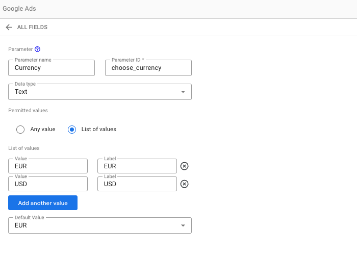

Tip 2: Combine parameters with calculated fields
The second tip is about embracing parameters . A parameter is a custom variable that gives the report viewers more control. The viewers can influence how data is transformed and calculated. Parameters make your reports more interactive and allow very specific filtering. If you’re new to parameters, we recommend checking out this introduction to parameters .
With parameters, you also need calculated fields . Calculated fields allow you to create new metrics and dimensions from your data.

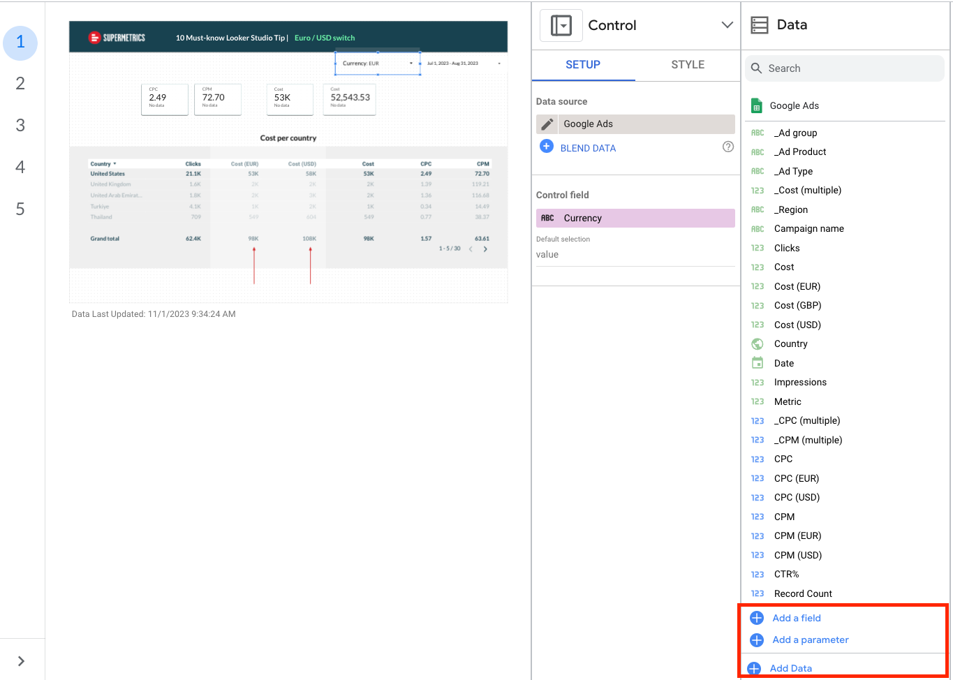

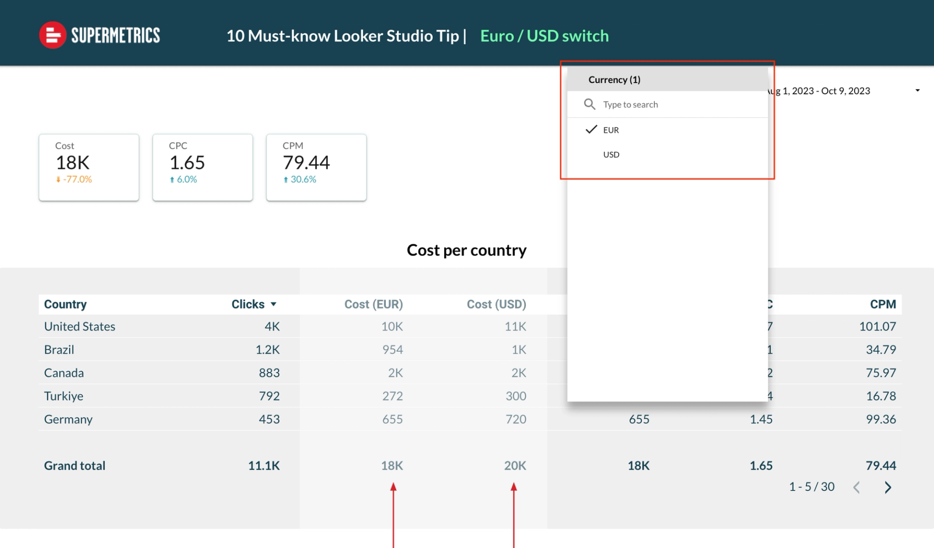

There are many ways you can use parameters and calculated fields together. One example is to create a currency switch. A currency switch is especially useful if you’re using multiple currencies, for example, Euros and US Dollars. You can see an example of a currency switch in the Looker Studio example dashboard .
Using the currency control, you won’t need two separate columns for costs in EUR and USD. You’d have one column for the cost that changes according to the selection in the currency control. You can start creating the currency switch by creating a new parameter.

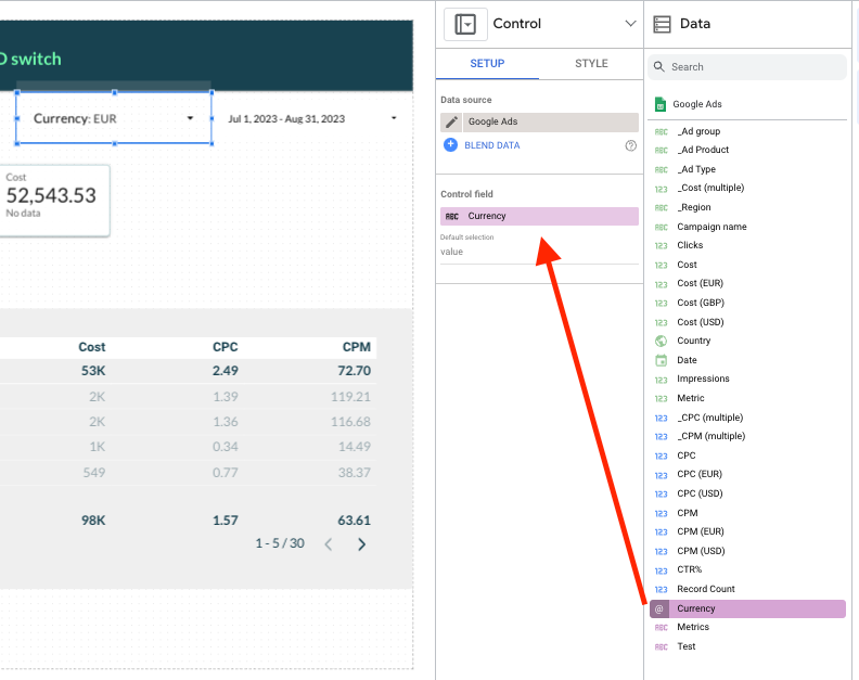

You can create a parameter under your data source. Just give a name, Looker Studio automatically creates a parameter ID, and then you can fill in the values.
Once you’re done with filling in the values, drag the parameter to your control field, and you get the currency selector showing.

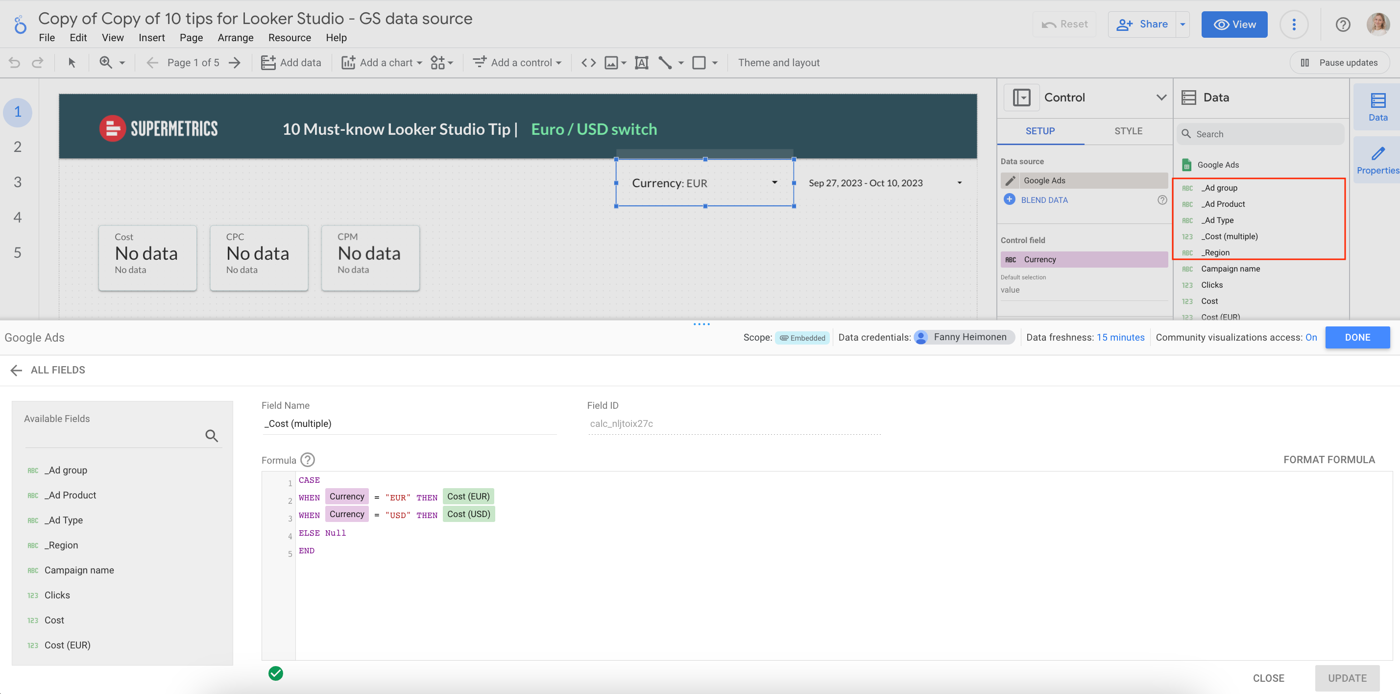

To get the control field to work, you need to create a custom field. You can create a new field under your data source—the same place where you created a new parameter.
It may make sense to use a similar naming convention for each calculated field, for example, starting with an underscore. This makes it easier to spot all custom fields among your data.

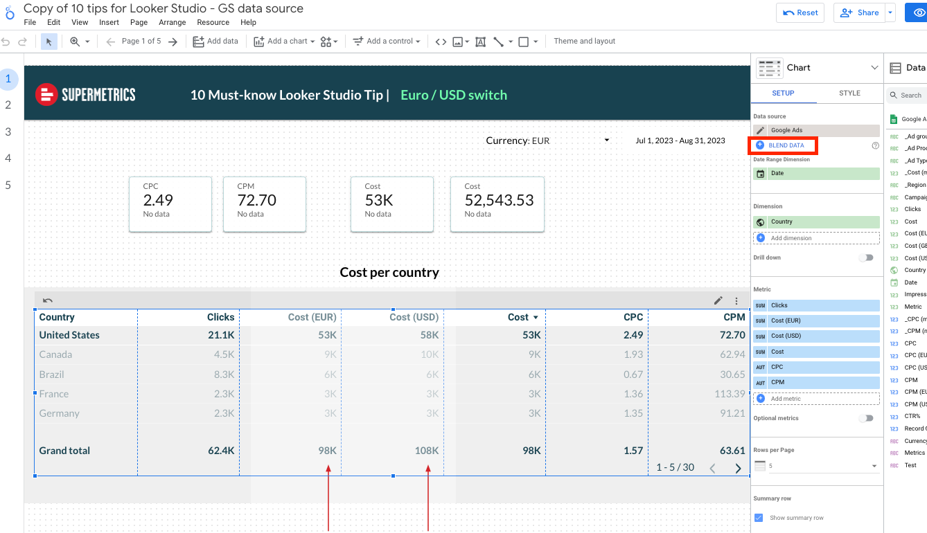

In the image below, you’ll see the formula for how we’ve created a calculated field for multiple costs. The parameter we just created—currency—is pink, and the new fields are green.
There are some prerequisites for creating new fields. In this example, you need to have the currency you’re looking for already in your data. If you don’t yet have it, you can make another custom field to transform it.
If you want to remove the underscores in your table or otherwise rename the custom fields, you can easily do that by clicking on the table and clicking on the metric you want to edit. You can also delete any unnecessary fields.

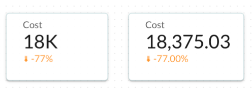

That’s why you should simplify your numbers and make them easy to read. You should decide, for example, how many decimals are actually needed for each metric. For example, a cost is much easier to digest and more visually appealing as 18K€ than 18,375.03€ as in the image below.
Shaping numbers is easy but has a huge impact on the report’s readability. You can shape your numbers by choosing the element you want to edit, going to “Style”, selecting “compact numbers”, and defining the decimal precision.
You can use the same instructions everywhere in your dashboard. To shape your tables, scroll down in the “Style” panel and set each column to “compact numbers”.

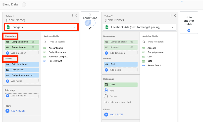

Follow these simple steps to get started with data blending in Looker Studio.

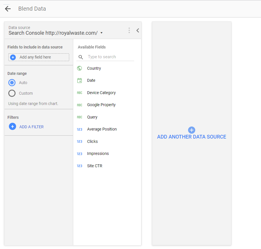

Step 1 : On your Looker Studio dashboard, select any element and click the “Blend Data” option under the “DATA” panel on the right.

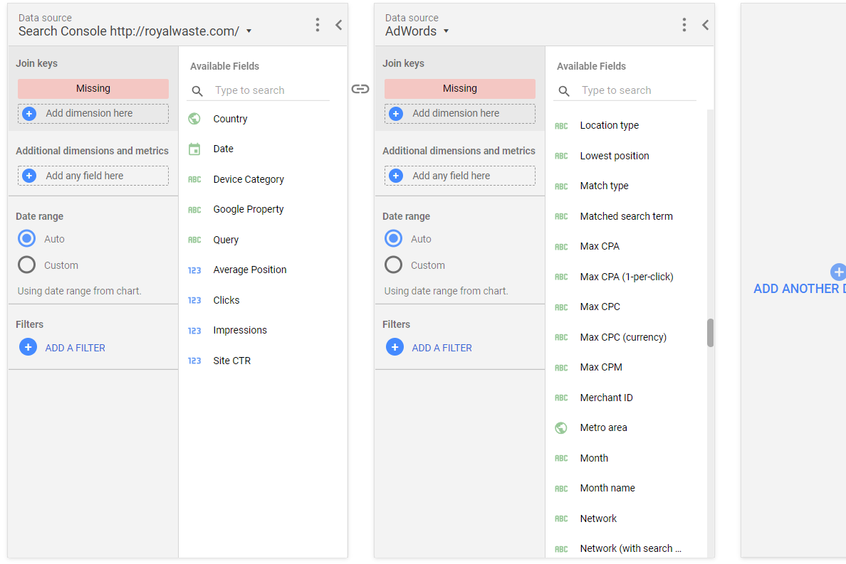

Step 2: Click “join table” and select your data sources. In the example below, we’re using a predefined dataset in Google Sheets as our data source.

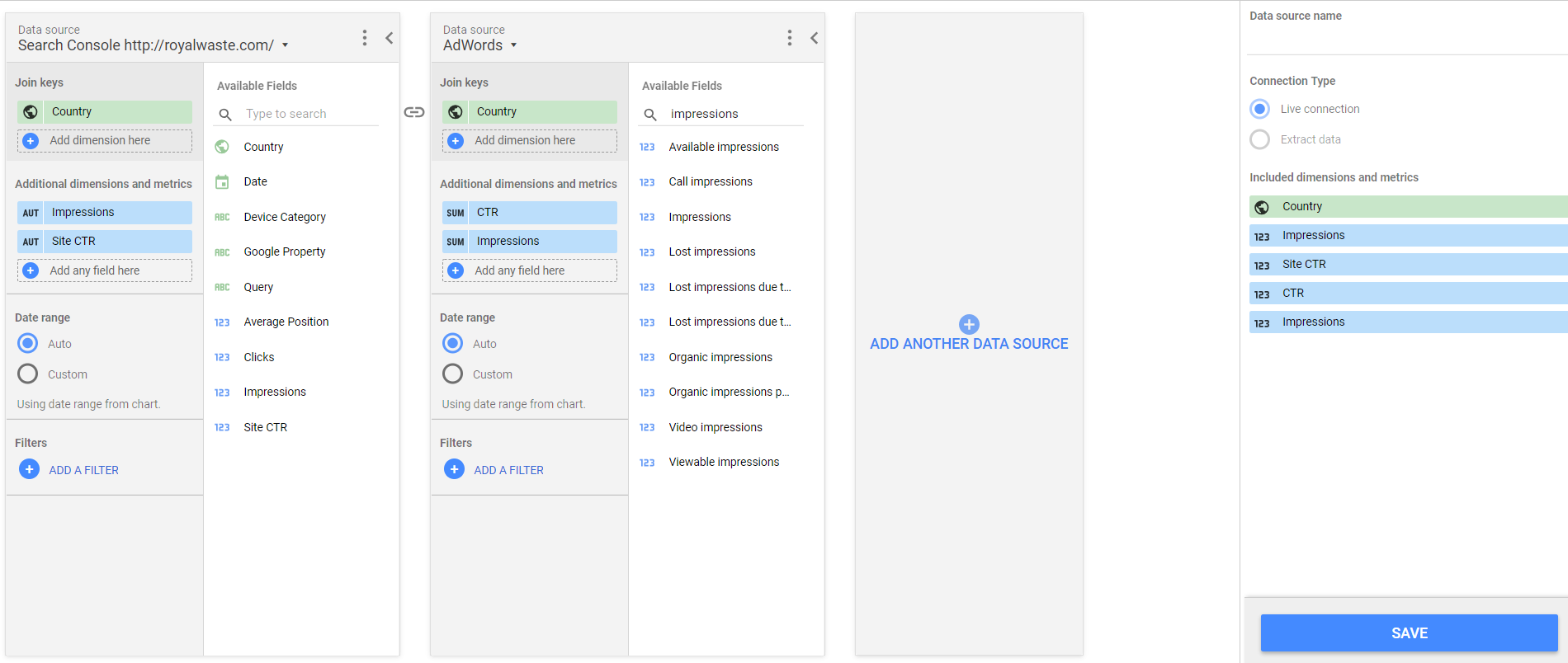

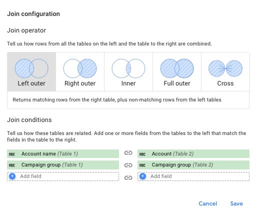

Step 3: Next, you need to configure the join by selecting the join operator and the join conditions.
You can blend data in Looker Studio with 5 different join operators. The results vary depending on the join operator you pick.
Step 4: Click “Save” and view your report.

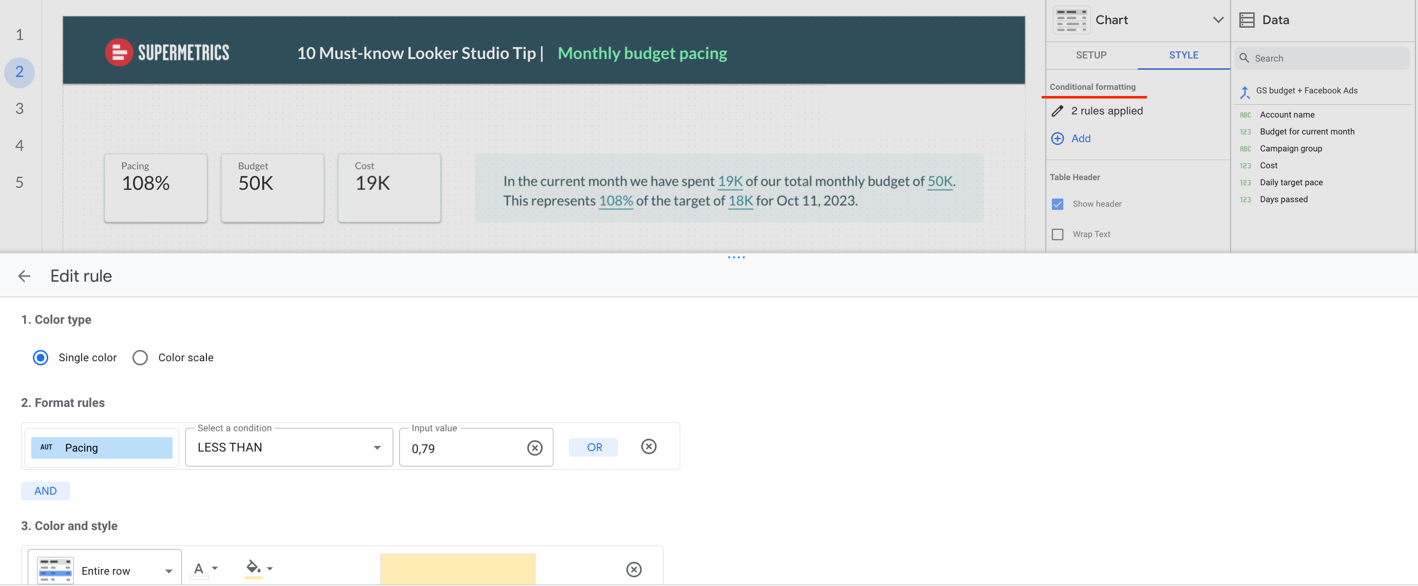

Tip 5: Conditional formatting
Conditional formatting is another easy tip, but it makes a huge difference on your dashboards. You can use conditional formatting in tables or scorecards. It lets you quickly spot outliers in your data by highlighting them with a specific color. One example use case is to highlight when you’re over or under-pacing your monthly budget.
You’ll find conditional formatting under the style panel.

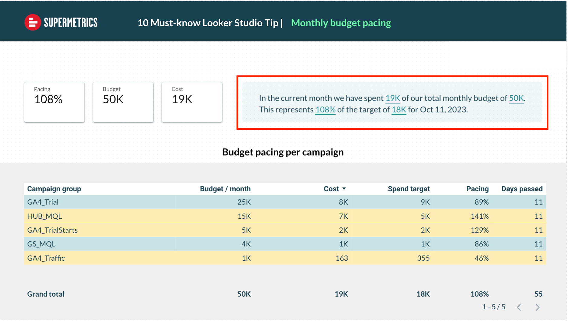

Tip 6: Use Tell Me chart to communicate your insights
As marketers, we often share the campaign reports with internal and external stakeholders. But, not all readers have the same level of data literacy. This means that they might not know how to read the dashboard and understand what’s going on.
We’ve created a free “Tell me” chart that allows you to add sentences to highlight the main takeaways from the dashboard. The “Tell me” chart is dynamic, so the numbers in the sentence will update according to your results. Below is an example of what it looks like in practice.
For example, you can create a command, “In the current month, we have spent X of our total monthly budget of Y. This represents Z% of the target for Oct 11, 2023”.

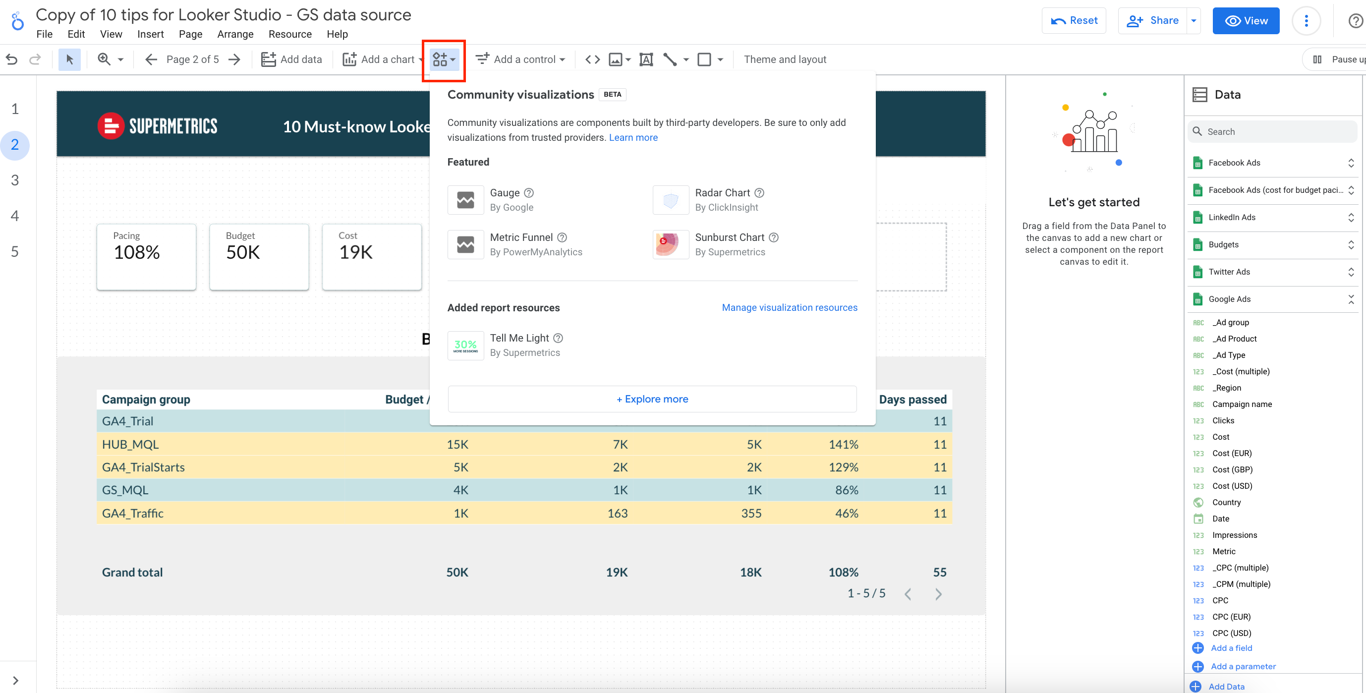

You can find the “Tell me” chart, as well as other Supermetrics charts, from the community visualizations tab and by clicking “Explore more”. Just select the “Tell me” chart and drag it to your dashboard.

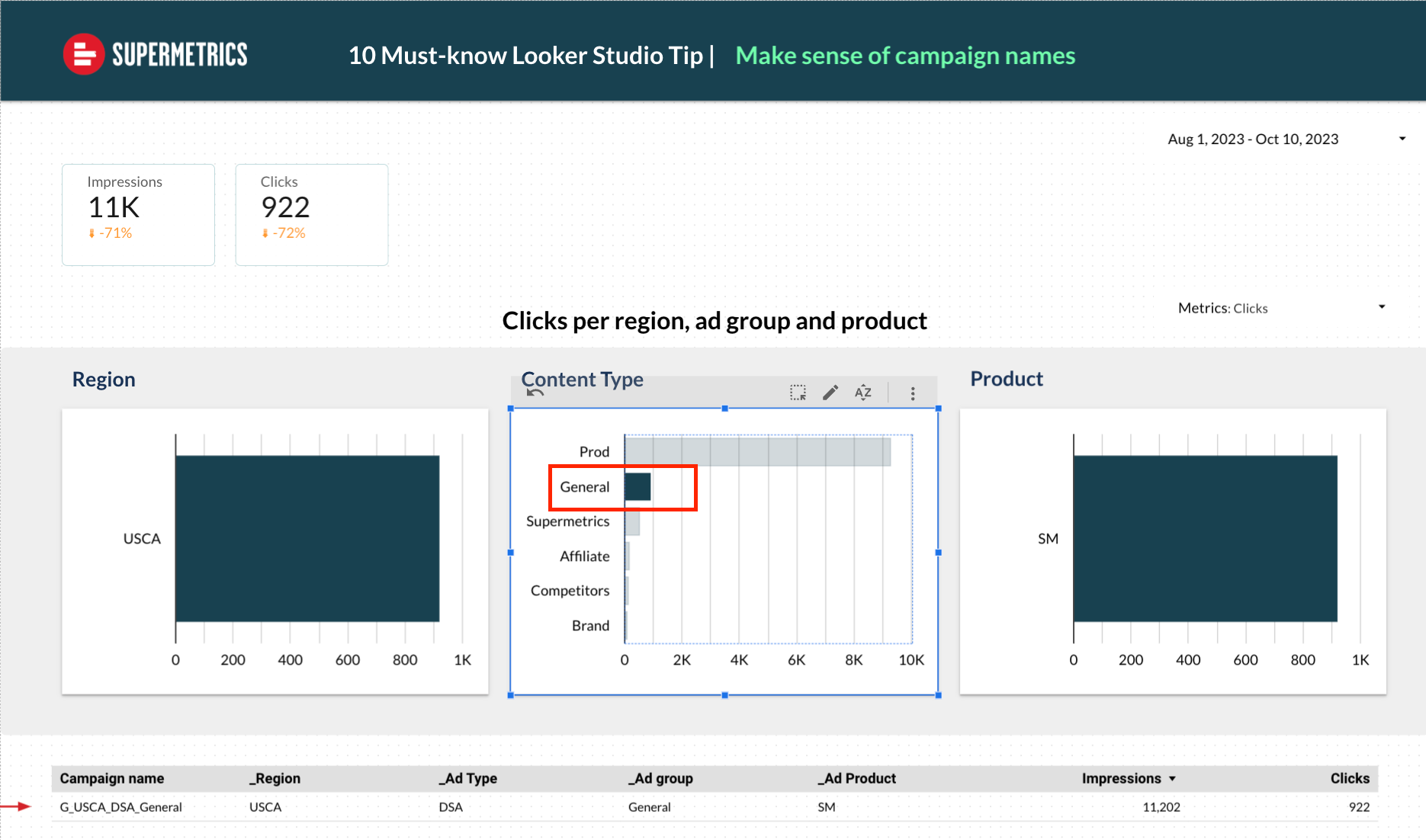

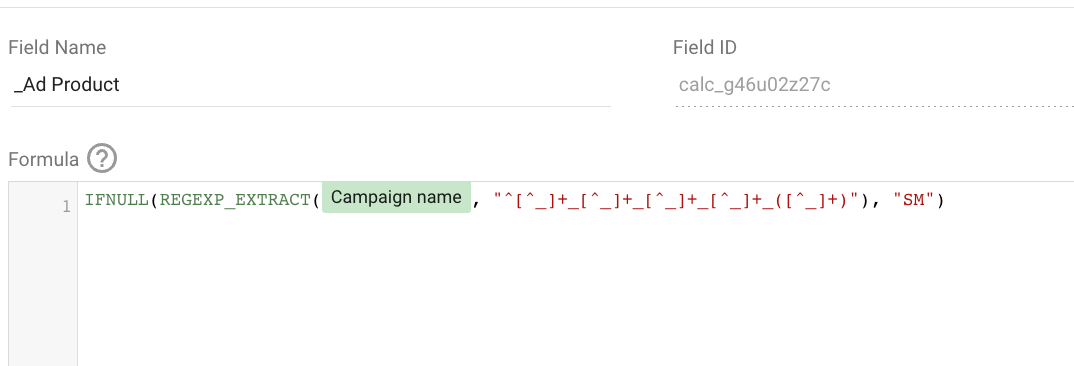

Tip 7: Regular expressions

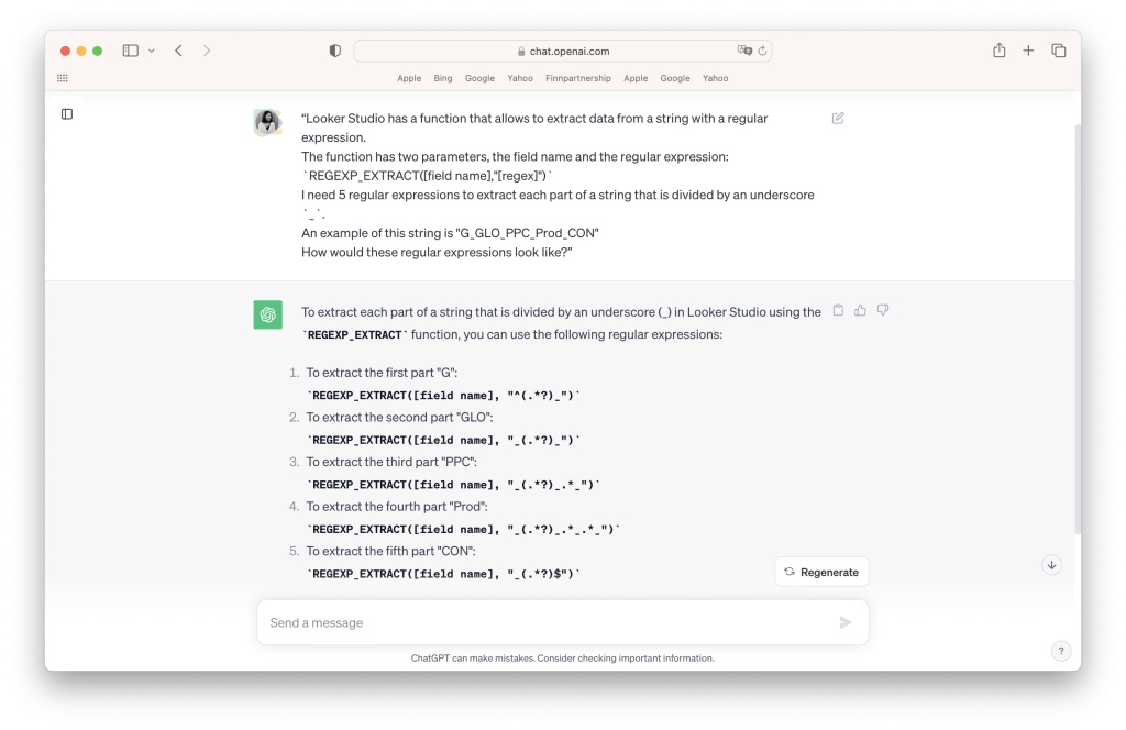

A regular expression, or RegEx, is a sequence of characters that specifies a match pattern in text. You can use RegEx to search, extract, or replace data from text.

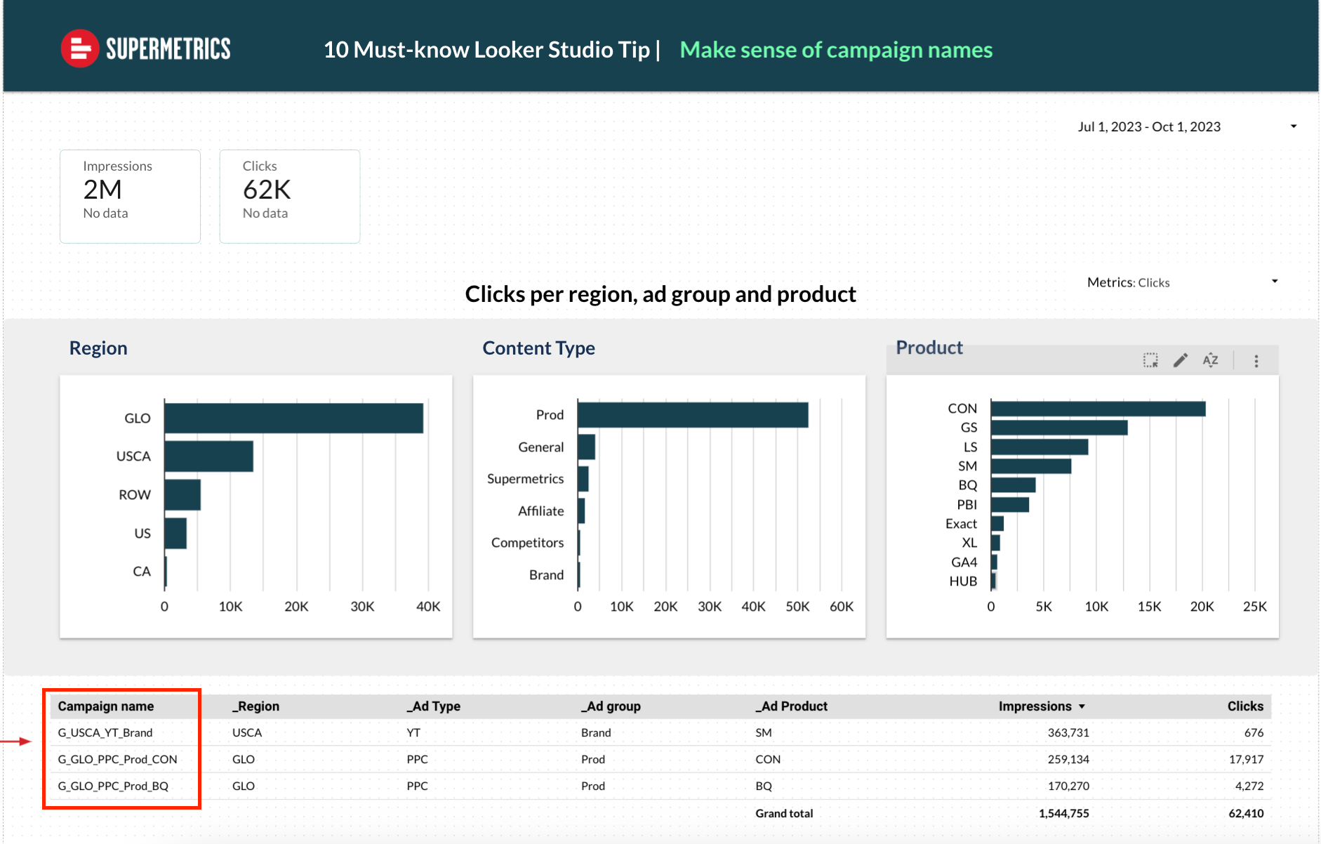

There are multiple use cases for regular expressions. We at Supermetrics have a unified naming convention for all our marketing campaigns. The campaign’s name can tell us many things, like the ad channel, region, content type, and product. By using RegEx, we can split the data with each of those pieces and capture them individually.
The RegEx formula shown in the image below looks like a lot of gibberish. It can be quite tricky to create and read, but one tip is to ask Chat GPT to create a regular expression for you.
Below is an example of how we asked Chat GPT for help. While making your request, it’s important to mention you’re using Looker Studio because there are different types of regular expressions with different language variations.
You can see that we told you we’re using a specific RegEx extract formula and want to look for a specific RegEx impression. And specified that we need five regular expressions to extract each part of a string that’s divided by an underscore, as in these examples.
“Looker Studio has a function that allows to extract data from a string with a regular expression.
The function has two parameters, the field name and the regular expression:
`REGEXP_EXTRACT([field name],”[regex]”)`
I need 5 regular expressions to extract each part of a string that is divided by an underscore `_`.
An example of this string is “G_GLO_PPC_Prod_CON”
How would these regular expressions look like?”

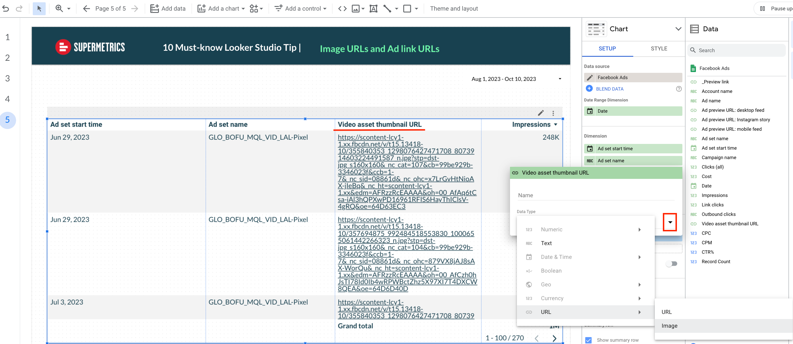

Tip 9: Create links and images in tables
Another great tip for improving the readability of your dashboards and finding insights is creating links and images in tables.
First, you need to add the video thumbnail URL to your dimensions. This will show it on your table. However, the URL format isn’t the most viewer-friendly, so let’s change it to show the actual image. Just click the pen icon, click the “Data type” drop-down, and change the type from “URL” to “Image”.
See how easy it is to add links and images to your tables (video) >>
