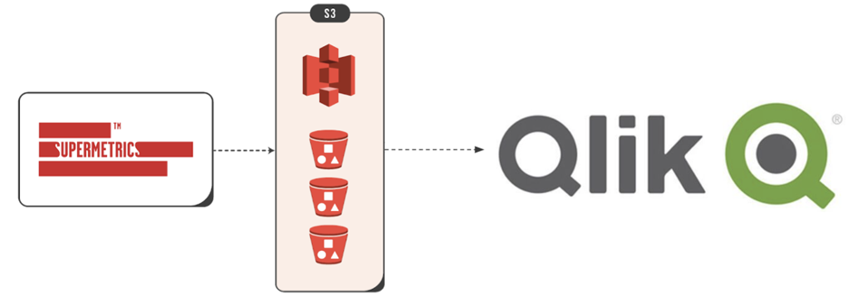

The team decided to build a data lake in Amazon S3 because they wanted to centralize and gain control over their marketing data. At the same time, they were also looking for a data pipeline that would streamline the data transfer process to Amazon S3.

Phase 1: Moving cross-channel data into Amazon S3 with Supermetrics
After agreeing on the needs and expected outcomes of the dashboard, the first step was moving CrediNord’s marketing data into Amazon S3, including:
  • Performance data in Facebook Ads and Google Ads.
  • Goal completion events and transactional data in Google Analytics.
Bartosz could easily set up the data transfer to Amazon S3 and create a custom schema to extract the exact metric and dimensions needed using Supermetrics.

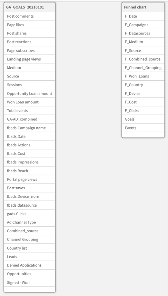

With the raw data ready in Amazon S3, Bartosz started loading, cleaning, and modeling the data in QlikSense. To make it easy for maintaining and transforming the data, he split the data load script into five sections.

Section 3: Custom mappings
The next step was implementing the mapping rules for CrediNord’s operational custom marketing channel groupings. First, Bartosz created initial mappings based on the ‘Source’ dimension— because Robert and Victor wanted that particular dataset to represent a specific segment of their marketing activities. Unwanted values of ‘Source’ were replaced with null-values in this dimension.
Second, he created the second custom dimension, ‘Channel grouping’, and implemented the mapping rules based on a set of rules using the previously created ‘Combined_source’ dimension along with additional input from other fields in the data.
Section 4: Join tables
The load script created a table with goal completion data from Google Analytics using the outer join. This way, the resulting table would contain 100% of both input tables so that the grand totals in the report are the same values as were exported from the sources.
Section 5: Unpivoted marketing data
The last section unpivoted the joined table so that ‘Goals’ becomes its own column. This was required for some of the graphs in CrediNord’s reporting dashboard.
In the resulting table, the ‘Goal’ column had all the goal completion values as dimensions. This is used mainly for the report sheet — which shows the conversion rates and cost breakdown by funnel stage. The unpivot was achieved using the ‘CrossTable’ function in Qlik.
The final result of the ETL process was a reporting layer with two tables.

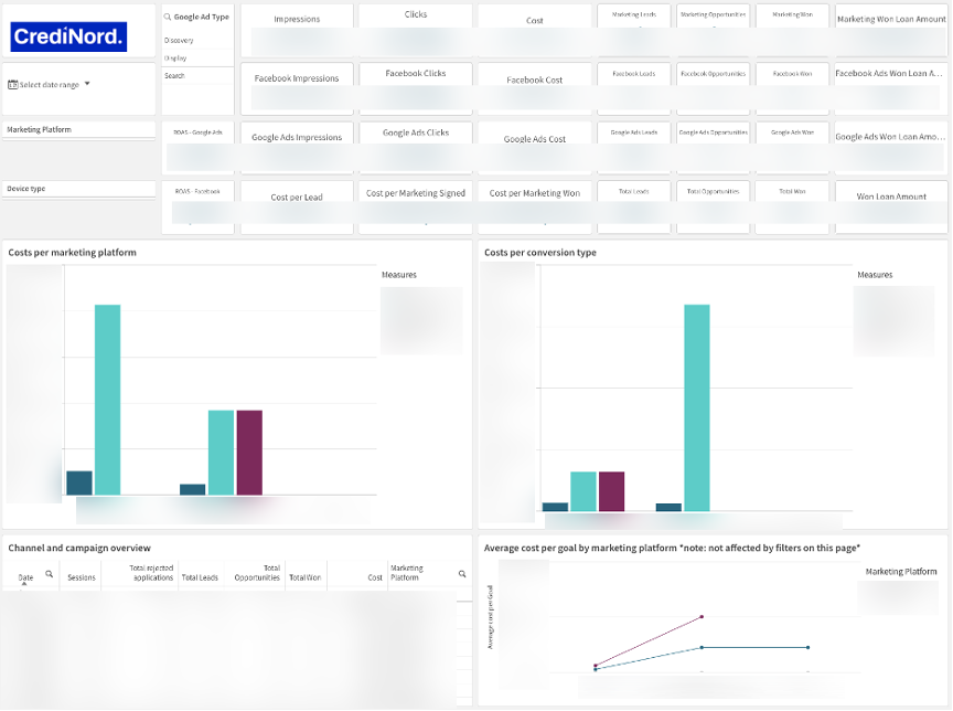

Marketing costs
The ‘Marketing cost’ dashboard provided a high-level overview of CrediNord’s marketing performance. With it, Robert and his team can easily understand how much they’ve invested in marketing and how much they’ve got in return.
Additionally, Robert often presents this page to the management team to show the impact of marketing on the business. He says, “For the management team, they are not interested in knowing which creative works best. They want to see the real business results driven by marketing actions. And the marketing costs page serves this need. On the other pages, we have more technical, drill-down data that helps us optimize our performance. ”
Marketing analytics funnel
The ‘Marketing analytics funnel’ visualizes CrediNord’s sales funnel into three stages: lead, opportunity, and won. Additionally, there’s a table on the right side showing the performance of each campaign. From here, they can easily see which campaigns are driving the most conversions.

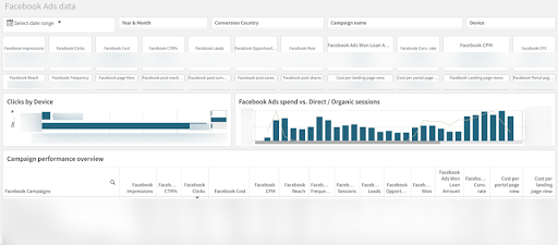

Facebook Ads performance
The next page focuses on Facebook Ads performance. From here, Robert and his team can find the scorecards representing the key Facebook Ads metrics and a table with a campaign performance breakdown.

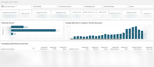

Google Ads performance
This page summarizes the performance of Google Ads. The scorecards show the most important metrics in Google Ads, including clicks, impressions, CTRs, and costs. Finally, the table at the bottom provides details on each Google Ads campaign.
