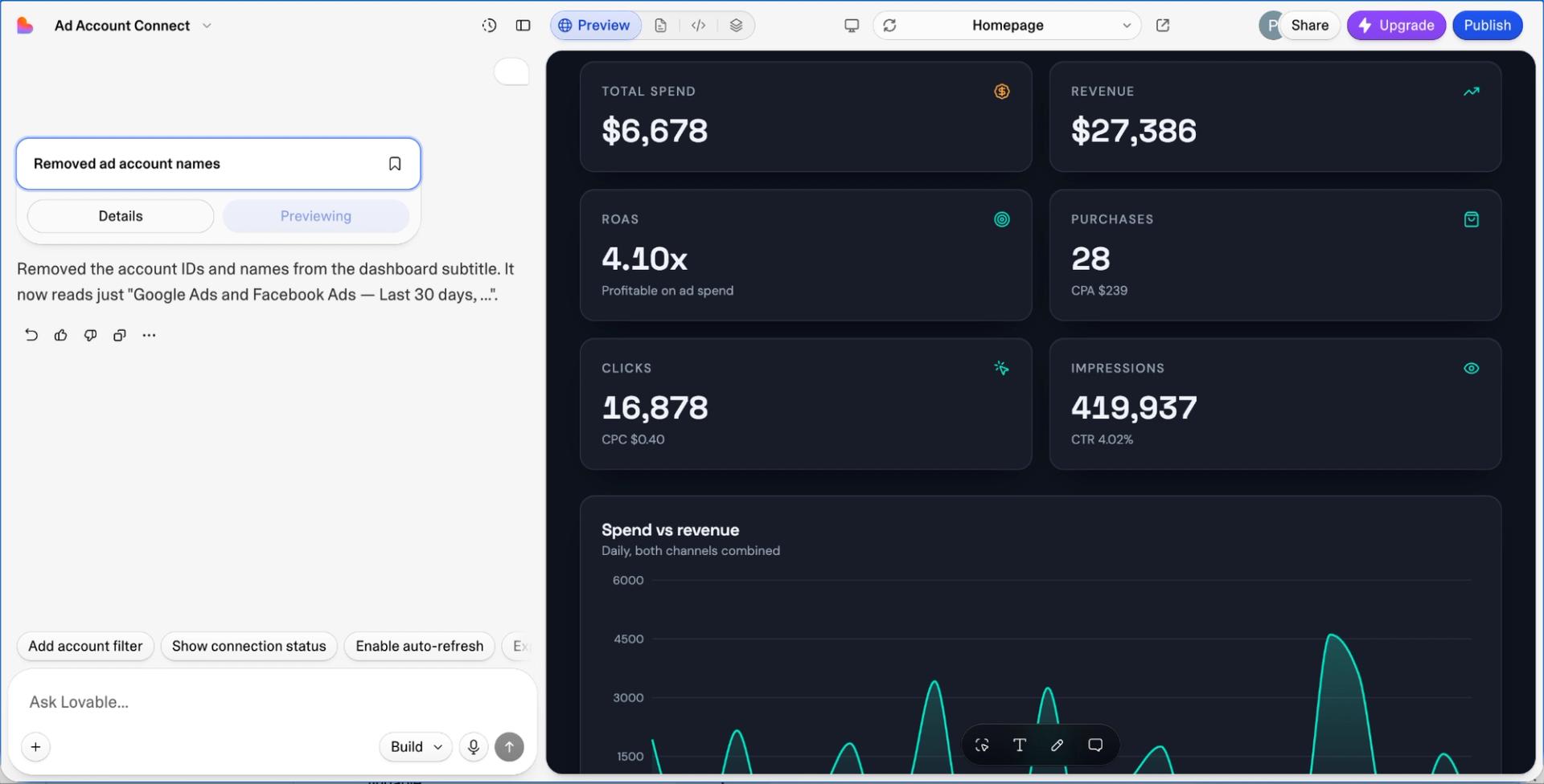

What changes when Lovable can read your Supermetrics data
With Supermetrics connected, Lovable builds against your real accounts rather than placeholder data. It knows which accounts exist, which metrics each source supports, and what your actual spend and conversion numbers look like. Without it, you get a good-looking shell and the wiring is still ahead of you.
- Actual field names. It knows your accounts exist, what they're called, and which metrics they support. No guessing at fields that were never there.
- Your real numbers to design against. Charts get built around your live spend and conversion values, so a layout that falls apart when one channel is 10x the others shows up immediately.
- Answers mid-build. Ask which campaign had the lowest cost per lead last quarter and you get the campaign name and the number, then decide whether it belongs in the app.
Building against live Supermetrics data means a layout problem shows up in the build, not the week after launch.

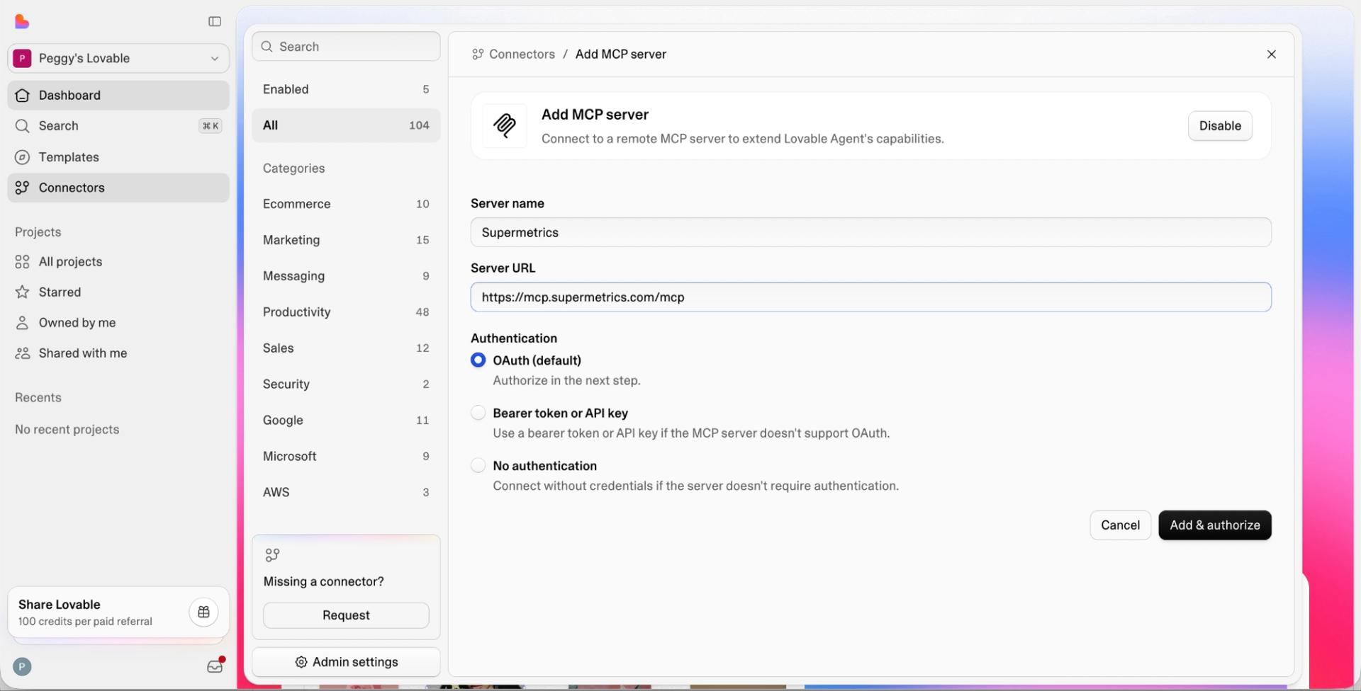

Connect Supermetrics to Lovable
Lovable calls custom data connections chat connectors, and they run on MCP, the Model Context Protocol, an open standard for connecting AI tools to outside systems
In Lovable's Connectors panel, as of August 2026:
- Open Connectors, scroll to the bottom of the All view, and select the Custom card labeled MCP.
- Enter a Server name. Supermetrics works nicely.
- Enter the Server URL: https://mcp.supermetrics.com/mcp
- Leave authentication set to OAuth, click Add & authorize, and sign in to Supermetrics.
If a colleague has already connected it, you can skip most of that. Supermetrics will appear under Used by others in this workspace, which fills in the server details and takes you straight to authorizing.
Supermetrics now appears in your chat connectors and is available across all your projects. The connection is scoped to your Lovable user account rather than the project, so a teammate opening the same project can't use it or see your data. They connect their own.

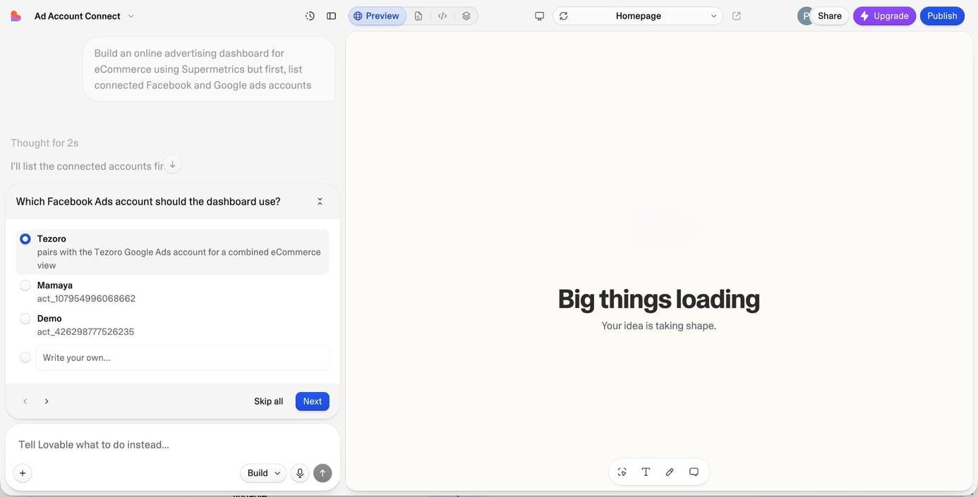

Check it works before you build anything:
"Using the Supermetrics connector, which data sources and ad accounts do I have access to?"
If your accounts come back, you're ready.

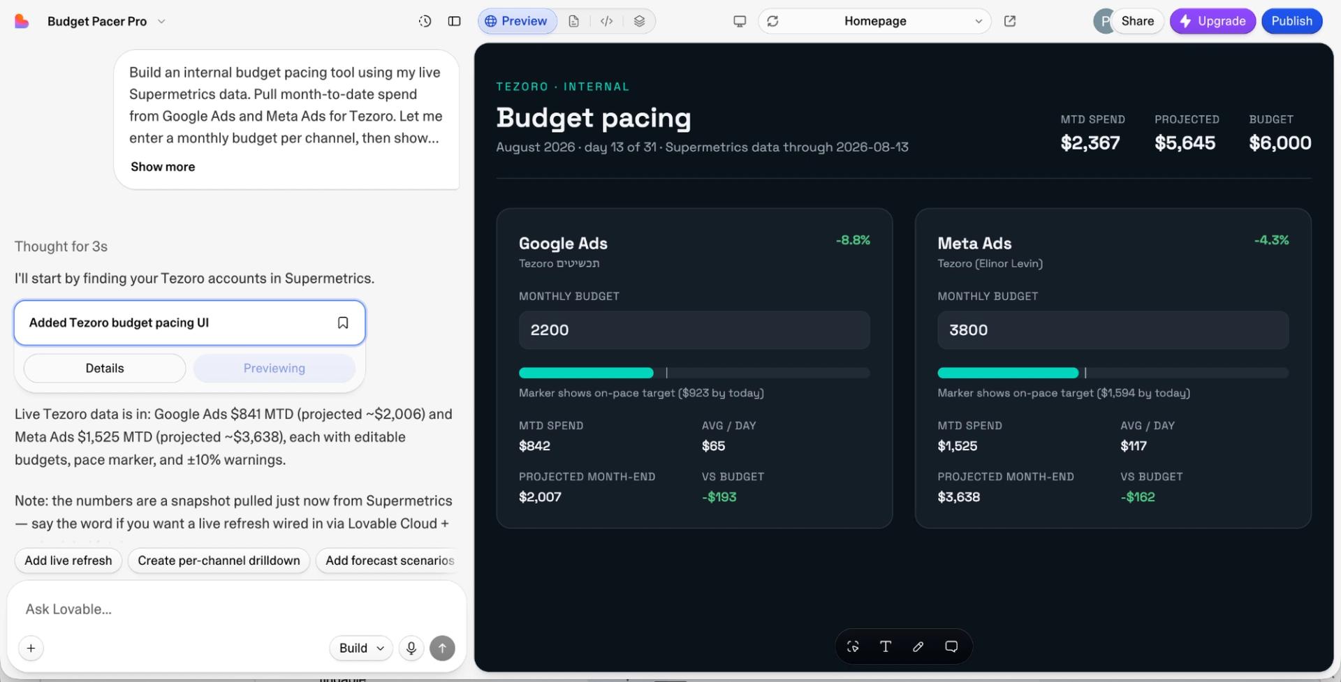

Budget pacing tracker
Know where spend is heading before the month ends, not after.
Sources: Google Ads, Meta Ads, LinkedIn Ads. What you get: a per-channel budget input, actual spend against pace, a month-end projection, and a warning at 10% variance.
"Build an internal budget pacing tool using my live Supermetrics data. Pull month-to-date spend from Google Ads, Meta Ads, and LinkedIn Ads. Let me enter a monthly budget per channel, then show actual spend against pace, projected month-end spend, and a warning when a channel is tracking more than 10% over or under budget."
